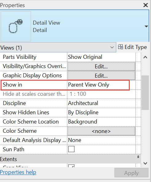

Yien_Chao
when you use detail View, you have the option of show in : parent vie2020-06-01_15-04-02.jpgw only.
