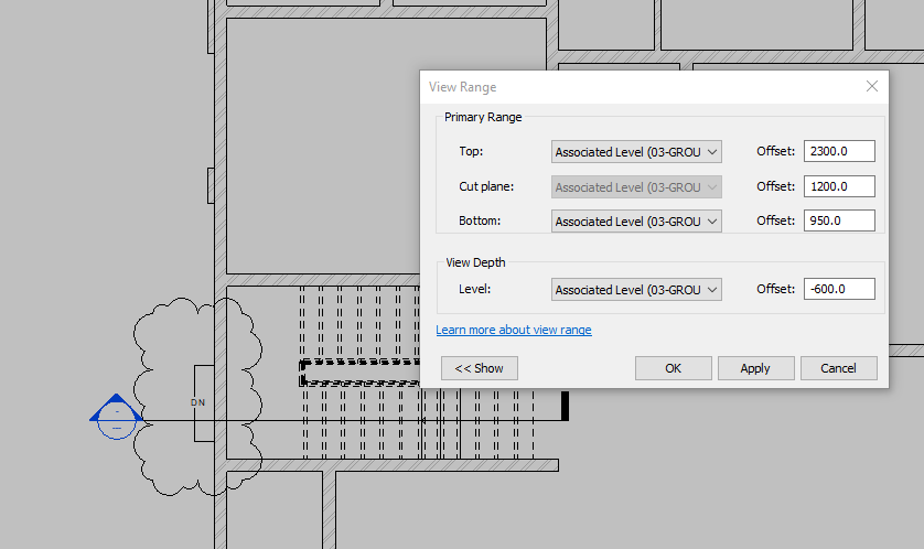

I found a very strange solution. Firstly the problem is related to the view range of the plan view.
I found that the stair will look correct when you set the bottom of the view range of the ground floor to 950mm above the ground level or any higher value.
I'm not sure if that will have another impact on the other elements in the view. But visually, I didn't notice any impact.
