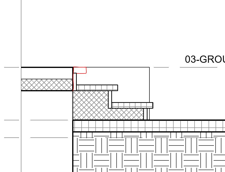

hello,
I am trying to create single step, but it is showing like in img below, it is extending beyond the tread,
I tried to change the connection method, the presentation is not correct

@ToanDN: Did you resolve the same way? Convert to Sketch?

No. But it maybe a better solution than mine.
Message 25 of 77
This was actually a booger for me.  I'm embarrassed.  Convert to Sketch was the way to go.  All downhill from there.

Uncheck End with Riser.
Message 28 of 77
HA! That's exactly what I was fighting. The built-in component stair intelligence.  Convert to Sketch and be done with it.

but in real situation we do have a riser with nosing no a slab edge

basma_salman
I guess it should look like this
Message 33 of 77
I get it. End with Tread or fasten non-slip nosing to landing as a separate component or use no landing nosing.

With your single step? You can't. You wouldn't to want to either.  You're fine without a nosing. What do you have there anyways? A door threshold? Well, there's your "nosing".

check below screen shot for explanation. The notch length should be considered in the total tread depth. if you want it to show as you desire. only change the tread depth to 200mm.

Can you set Connection Method to Straight Cut and resolve the "jut" seen in Section?  I couldn't.

For the two steps stair, you can follow below configuration of notch.
