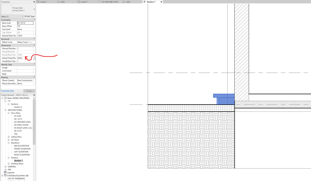

hello,
I am trying to create single step, but it is showing like in img below, it is extending beyond the tread,
I tried to change the connection method, the presentation is not correct

This is the booger that I (and the OP) are talking about.  What do you think?  Can you remove without converting to Sketch-Based?  School me.

MostafaElashmawy
I could remove it only with changing the tread depth to 200mm instead of 300mm.

basma_salman
I removed it with the cut profile tool from the view tab, and this is only a 2d modification

basma_salman
interesting, I did not go through the notch settings before, I will check it, thank you @MostafaElashmawy
What do you mean?  You don't need to cut geometry.  @MostafaElashmawy gave the solution. I tested it. It was ridiculously simple. I'm embarrassed, @RDAOU is laughing and@ToanDN, I think, went home early to see if there was any leftover champagne to drink.

basma_salman
this what happens when I make depth 200
Message 51 of 77
basma_salman
oh, I first have to change the straight cut into notch and then change the depth to 200
it is working perfectly thank u everyone
