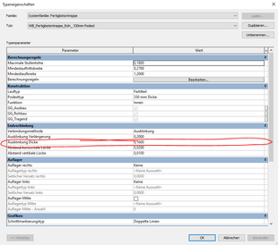

Hallo everyone,
we have noticed in our model that the stair depth is different between top and bottom, as seen in the picture below.
As seen in the second picture, the staircase should follows the red line, so the right depth should be 20 cm.
any ideas how to fix this?

the depth is already set to 20 cm,

you expecting bottom and top difference width?

Notch Thickness.

yes exactly, as seen in the first picture i posted, you can see the difference even though the depth is set to 20 cm,

the Notch thickness, does not affect the stair depth.

so it worked,
i only had to extend a bit the width of the last step.

@yazanhijazeen: I don't understand what your solution was.  Can you say again?

@barthbradley the Notch Thickness only changed these two thicknesses as see in the picture ( First and last step ) and did not affect the depth, plus i need the thickness to stay as it is for stair design reasons.
 What i have done is that i extended the last step width ( only 2 mm). The depth is back to 20 cm, but a small part is missing as seen in the picture that would be replaced by a mass.
