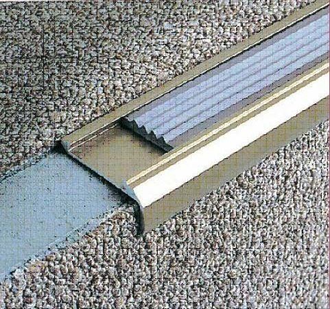

Hi

I'd do it as a Tread/Tread Profile -- not Nosing.
...the bottom screenshot looks prefect.  What's wrong with that one?
Change Nosing Length to match the profile dimension.
