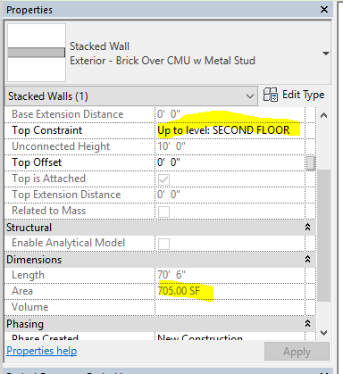

There is an error if the area calculation.
If you draw a stacked wall with an unconnected height of 20' and you make it 70' long. Then attach the top to a roof 10' high.
The area should be 700 SF. But Revit will tell you it is 1400 SF.
This only happens with stacked walls. other walls seem to calculate properly, and if you edit the profile of the wall it seems to calculate properly.

Sahay_R
This is what I got with 2018
This is also what I got in 2017

I created the same exact problem in 2018 my 70'-6" long by 10 high wall has an area of 1400 SF

Sahay_R
Your wall is unconnected and not constrained to level 2, which is where my roof was. Compare the differences between your screenshot and mine.

I can replicate the behavior if the wall is Unconnected, see the 1st and 2nd screenshots.  To fix it, you need to change the stacked wall to Connected, see screenshot 3.

When I make the wall connected to a height then it calculates to the connected height and not to the roof.
Message 8 of 15
that only works if the level and the roof are the same ... what about a sloped roof .... FAIL
You are correct.  It does sound like a bug.  The only way I can think of is using Edit Profile instead of attaching to Roof.

Ya ... I figured out the edit profile part
But if you move the roof then the wall is wrong ...

Sahay_R
I got my results with stacked wall connected to a flat roof.
Lock the profile line to the roof plane.
