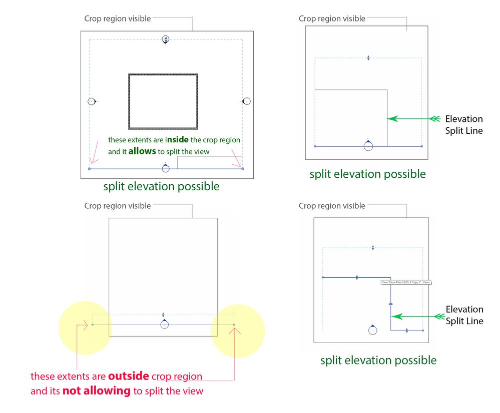

Corsten.Au
Hi
I think I Cracked the solution this time...
The Extents of elevation should be inside ( within ) the Crop Region.
Otherwise Revit doesn't allow to split...
( Now this is not the standard setting in Revit, different versions of Revit behaving differently )
Am pretty sure you are facing this situation..
Let us know

@Corsten.Au: Good one! Smiley Wink
