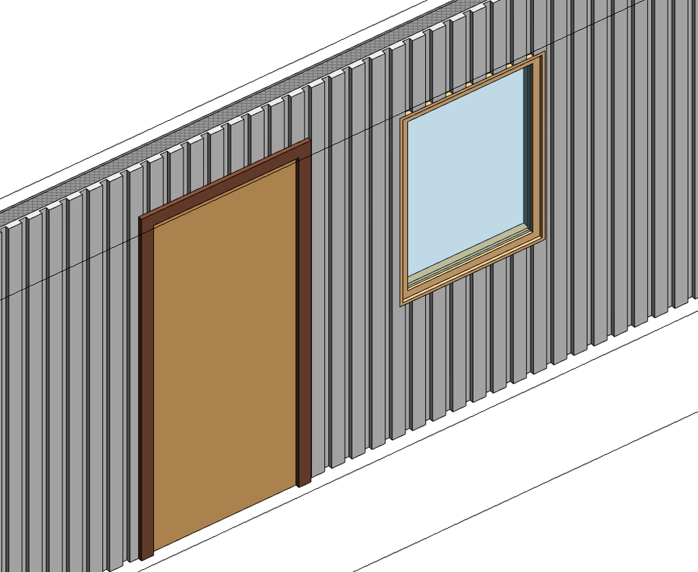

You can just create them as normal walls and array a vertical wall reveal (or wall sweep) to create the look. Although, the recommended approach is using a proper material with Relief pattern (bump) for appearance and a model pattern for graphic.
Here is using a normal wall type with reveals.

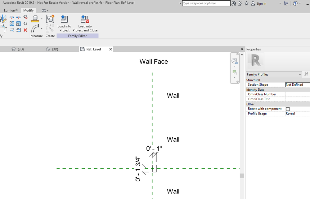

thank you. how do you change the dimensions of the wall sweep?
Wall sweeps and wall reveals are based on profiles.  You can create a new family based on Profile-Reveal family template to draw the profile shape, then load it in project and assign to a Wall Reveal type.
