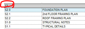

Is there a way to have the sheet discipline shown as a  Header in the sheet index? ( like the way ARCHITECTURE is shown as a header) Other Disciplines models are linked to our model and they don't have the Discipline identified in the sheet properties. I'm using Revit 2020 and we are using Bim360 -not sure if this matters -

Got another idea for you @raysanziaei
You say "Other Disciplines models are linked to our model and they don't have the Discipline identified in the sheet properties".   What about entering the Discipline Name into the Link's "Name" field, adding the "RVT Link: Name" Parameter Field to your Schedule and then use this Parameter value as your Header?
Message 35 of 47
Message 36 of 47
raysanziaei
So I need to ask all different consultants to have the same PROJECT PARAMETER- in this case named "Sheet Discipline"- in their models. Then have all their sheets "Sheet Discipline" parameter say their Discipline e.g. Civil, Structural ,,, This way, when I populate the sheet index, each consultant's sheets show up under their relative discipline. Is this correct?
Message 37 of 47
Why don't you just do it the way I suggested last?  Name the Link in your Project by its Discipline.  No need to impose on the other Disciplines then.
Message 38 of 47
raysanziaei
Should I make a parameter named RVT Link?
Message 39 of 47
1. Enter the Discipline Name into the Link's "Name" field.
2. Add the "RVT Link: Name" Parameter Field to your Schedule.
Message 40 of 47
raysanziaei
Thank you. How do I change the name of the RVT link models?
