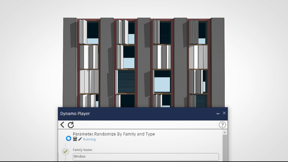

I wanted to share this with you guys, it's fresh in Youtube now,
Enjoy watching it 😄
Randomizing Parameters and Types Scripts
Very easy to use, very stable, and very fast
Created for Revit with Dynamo
