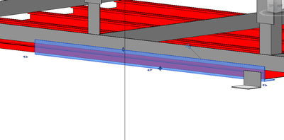

hi all,
I am creating (or trying to) a parametric family.
I have used ref lines instead of planes to ensure handles are available in 3D, but the handles don't seem to stretch the family, they move it along the work plane instead, and when I change the size through properties, the shape handles move along, but not the object.
Can someone help with this?  I have looked through the forums and tried countless solutions.
Any help is appreciated, pic and family attachedScreenshot 2023-11-20 160715.png

Simply edit the sketch of the extrusion. Align and lock both ends of the sketch to the correspondent reference line. Then it works. How was this supposed to work if the sketch was not related to the references?

Grip stretch the extrusion to meet the ref line and lock it.  Do it for all of them.

I wasnt locking the extrusion when editing i was locking something else.
