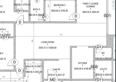

this only works for rectangular rooms it's not working for different shapes like L shape room or c shape room, where we need the longer length to display. is there way for that?
for example, see living room dimensions
How do you determine width and length of non rectangular rooms and does it even make sense?
