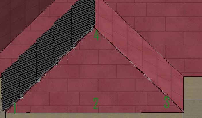

zs-17
It works only on a roof with 4 points. I have sides with less and more than 4. Is there a way to do it?
Message 8 of 44
For 3 sides, place the family with 3 points aligned and one point off so it is still a triangle.
For more than 4 sides, place it several times.
Message 9 of 44
zs-17
I tried below 2 scenarios with success. ( point 3 and 4 in second photo are next to each others and not on top of each others.

zs-17
Yes I did this mistake. I still have the challenge to do it with more than 4 points.

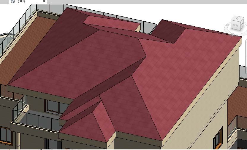

Message 13 of 44
zs-17
In this condition 3 models should be created next to each others. But I can't remove the cut line in between
Message 14 of 44
You could create a mass based on the roof, divide surface, and load the tile as a generic model pattern based and it will populate the entire surface automatically.  Share your roof model I can show you.
Message 15 of 44
zs-17
I attached the file

Message 18 of 44
zs-17

Message 19 of 44
Sorry. Before start the Mass, go to Mass & Site tab, click the Show Mass... button drop-down (2nd from the left on the ribbon), and choose Show Mass Form and Floors.
To recap:
- Enable view of Mass following the step above
- Start an in place Mass
- Set the workplane to a roof surface where you want to place the tile
- draw a closed loop Reference lines following the roof surface boundary
- select the closed loop reference lines and create form, choose 3d form, not 2d face
- grip edit the form so that the intended face is on top
- select that face and create divided surface
- change U and V to distances to match the family (39 cm and 24.5 cm)
- select the divided surface and change it to the correct roof tile from the type selection
- finish the mass
It sounds like a lot of steps but if you watch the screencast, it takes just over 1 minute.
