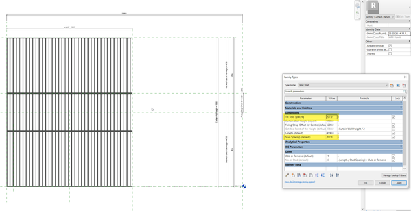

I have created a Stud wall Family but it isn't working on the project file when loading it shows in the project browser.
this is very important I have spent 1 whole day making this family.
some one resolve this issue

This family is a Curtain Wall Panel. So i assume your placing a curtain wall with no mullions and and swopping out the Panel?

@jazzsharma200 the family you have created is a Curtain Wall Element (not sure the exact english term as i am more used to the German Revit Terminology). As you can see in the screenshot below I am able to place it without any issue. You will have to place a normal curtain wall from revit, place the posts and then the element in between can be swaped with your family. Video Attached.

You can model this in the Project with Curtain Walls or Beam Systems using your "I Stud" Profile for Mullions or Beams.

but it doesn't fill all the length.

This family you created is very inflexible when being used in the project.  Use curtain walls with mullions for stud framing.  If you model wall framing for a living than invest in some specialized add-in such as AGACAD.

Saved in a later version of Revit I am using Revit 2021

yes but it is not working in the project

several of us have tried using this curtain panel family with success. This issue is either with your model or how its being used.
If this has not been resolved yet, please consider uploading a Model file (RVT) you are trying to use this family in.
