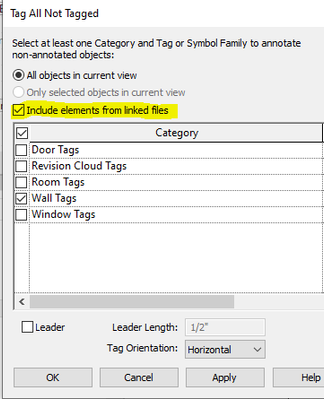

Coming back to this in the morning, I realized we have the Tag All command.
Even though this dialog includes the option "Include elements from linked files", it will not tag rooms from linked files (including untagged rooms in the linked model). I interpret this option to mean that the command will "see" the room elements in the linked model and tag them in this view. Of course this is not the case, and will only tag live rooms in the parent model, disregarding my interpretation of the option.
However, using the two below articles, links need to be have their Phase Mapping correctthe view needs to be set to coordination, and the view needs to be uncropped. I believe this "Include elements from linked files" needs to be greyed out until these conditions, at least for the active view, are met.

Tag All does work with linked models.
View discipline does not need to be set to coordination.
Reference type does not need to be Attachment.
Room Bounding does not need to be turned on.
You've got something else preventing your room tags from showing. Phasing is the first thing that comes to mind, if you're still interested in a solution.
Your interpretation is correct. It's not an "artificial limitation" that you are experiencing. Rooms in linked models can be tagged.
To respond to the above, following my previously posted links brought me to the conclusion that one of the above conditions was the issue. Phasing is not a concern and does not have an impact, as it is all new construction. I'll test to see which specific option is causing the error.
The goal of this post originally was to find a solution to prevent repeat work, i.e. replacing tags in the parent model for links that have already been tagged. Therefore, if there are any other solutions to prevent this repeat work in this scenario, feel free to add. Otherwise, replacing all tags with the Tag All command is my current workaround.
