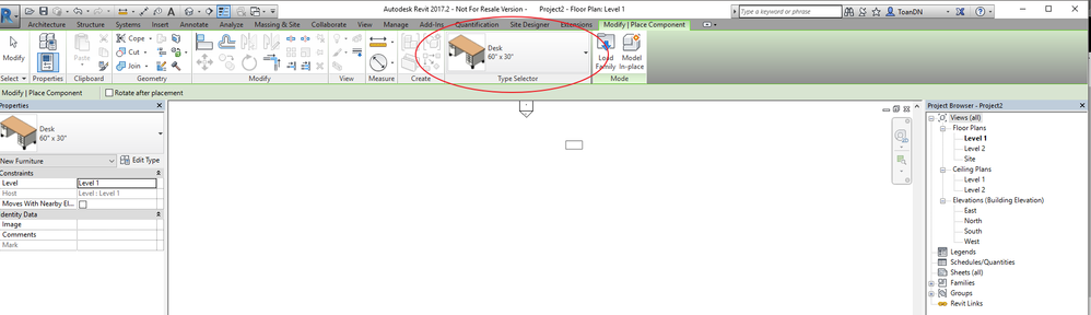

I pinned the Type Selector to the middle of the Ribbon to cut the distance to half.
