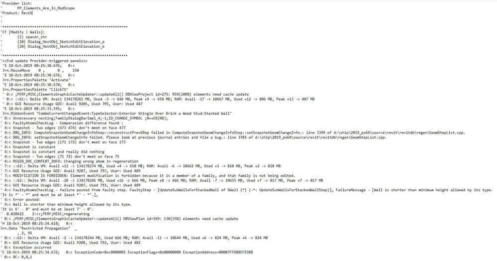

I found what i think looks like a crash event:
'CT [Modify | Walls]:
' {1} spacer_shr
' {10} Dialog_HostObj_SketchEditElevation_a
' {20} Dialog_HostObj_SketchEditElevation_b
'<<End update Provider-triggered panels>>
'E 18-Oct-2019 08:25:30.676; 0:<
Jrn.MouseMove 0 , 0 , 150
Jrn.PropertiesPalette "Activate"
'E 18-Oct-2019 08:25:30.678; 0:<
Jrn.PropertiesPalette "ClickTS"
' 0:< ;PERF;MISC;ElementsGraphicCacheUpdater::updateAll() DBViewProject id=275: 959(100%) elements need cache update
' 0:< ::61:: Delta VM: Avail 134178261 MB, Used -3 -> 646 MB, Peak +9 -> 658 MB; RAM: Avail -17 -> 10667 MB, Used +12 -> 806 MB, Peak +13 -> 807 MB
' 0:< GUI Resource Usage GDI: Avail 9205, Used 795, User: Used 487
'E 18-Oct-2019 08:25:33.595; 0:<
Jrn.RibbonEvent "ComboCurrentChangedEvent:TypeSelector:Exterior Shingle Over Brick w Wood Stud:Stacked Wall"
' 0:< Unnecessary nesting;FamilyDialogBarImpl_4;-1;ID_CHANGE_SYMBOL ;N++EB(NB);
' 4:< FaultyAtomsCheckLog - Comparasion difference found :
' 4:< Snapshot - Two edges (473 474) don't meet on face 477
' 4:< DBG_INFO: ComputeSnapshotGeomChangeInfoStep::reconstructPrevGRep failed in ComputeSnapshotGeomChangeInfoStep::setSnapshotGeomChangeInfo.: line 3399 of d:\ship\2019_px64\source\revit\revitdb\regen\GeomStepList.cpp.
' 4:< DBG_INFO: setSnapshotGeomChangeInfo failed. Please look at previous journal entries and file a bug.: line 3785 of d:\ship\2019_px64\source\revit\revitdb\regen\GeomStepList.cpp.
' 4:< Snapshot - Two edges (171 172) don't meet on face 173
' 4:< Snapshot is constant
' 4:< Snapshot is constant and really did nothing
' 4:< Snapshot - Two edges (71 72) don't meet on face 75
' 4:< REGEN_DOC_CONTEXT_INFO: Changing wrong atom in regeneration
' 7:< ::62:: Delta VM: Avail +12 -> 134178274 MB, Used +4 -> 650 MB; RAM: Avail -6 -> 10662 MB, Used +3 -> 810 MB, Peak +2 -> 810 MB
' 7:< GUI Resource Usage GDI: Avail 9207, Used 793, User: Used 489
' 7:< MODIFICATION IS FORBIDDEN: Element modification is forbidden because it is a member of a family, and that family is not being edited.
' 4:< ::62:: Delta VM: Avail -28 -> 134178246 MB, Used +16 -> 666 MB, Peak +8 -> 666 MB; RAM: Avail -7 -> 10655 MB, Used +7 -> 817 MB, Peak +7 -> 817 MB
' 4:< GUI Resource Usage GDI: Avail 9207, Used 793, User: Used 489
' 4:< FaultyAtomsCheckLog - failure posted from faulty step. FaultyStep - [UpdateSubWallsForStackedWall of SWall {*} (-*: UpdateSubWallsForStackedWallStep)], FailureMessage - [Wall is shorter than minimum height allowed by its type.
'It is *' - *" and must be at least *' - *".],
' 4:< Error posted:
' 4:< Wall is shorter than minimum height allowed by its type.
'It is 6' - 0" and must be at least 7' - 0".
' 0.820622 2:<<;PERF;MISC;regenerating
' 0:< ;PERF;MISC;ElementsGraphicCacheUpdater::updateAll() DBViewPlan id=369: 130(55%) elements need cache update
'H 18-Oct-2019 08:25:34.618; 0:<
Jrn.Data "Restricted Propagation" _
, 2, 95
' 0:< ::62:: Delta VM: Avail -2 -> 134178244 MB, Used 666 MB; RAM: Avail -11 -> 10644 MB, Used +6 -> 824 MB, Peak +6 -> 824 MB
' 0:< GUI Resource Usage GDI: Avail 9208, Used 792, User: Used 482
' 0:< Exception occurred
'C 18-Oct-2019 08:25:34.632; 0:< ExceptionCode=0xc0000005 ExceptionFlags=0x00000000 ExceptionAddress=00007FFD80EFE98B
' 0:< BC: 0,0,1
' 0:< System (MB) [Available / Total ] [Revit Memory Usage (MB) ]
' 0:< RAM Statistics: 10649 / 16309 824=InUse 824=Peak
' 0:< VM Statistics: 134178245 / 134217727 666=InUse 666=Peak
' 1:< ::62:: Delta VM: Avail +7 -> 134178251 MB, Used -9 -> 657 MB; RAM: Avail +102 -> 10746 MB, Used -1 -> 823 MB
' 1:< GUI Resource Usage GDI: Avail 9208, Used 792, User: Used 475
' 1:< Revit worker 1 closed cleanly
' 0:< [000028d4]QueueMinder stopped
'C 18-Oct-2019 08:25:35.706; 1:< logging finished virtualization services
'C 18-Oct-2019 08:25:35.706; 1:< logging finished worker services
'C 18-Oct-2019 08:25:35.708; 1:< logging erased queues
' 1.070567 1:<<<Terminating Slave Processes
' 0:< ::62:: Delta VM: Avail +33 -> 134178285 MB, Used -1 -> 656 MB; RAM: Avail +25 -> 10772 MB, Used 823 MB
' 0:< GUI Resource Usage GDI: Avail 9206, Used 794, User: Used 457
' 0:< DBG_INFO: An active transaction phase on the stack while UndoMgr has no transaction currently open!: line 4966 of d:\ship\2019_px64\source\revit\revitdb\undo\UndoMgr.cpp.
' 0:< DBG_WARN: Unexpected Undo Commit Phase!: line 5196 of d:\ship\2019_px64\source\revit\revitdb\undo\UndoMgr.cpp.
' 0:< DBG_INFO: UndoMgr stacking is out of sync after finishing a transaction: line 1139 of d:\ship\2019_px64\source\revit\revitdb\undo\UndoTransaction.cpp.
' 0:< Unconverted MessageBox "A fatal error has occurred. The application will be terminated. You have the opportunity to save recovery files for all of your changed projects.
'Would you like to save a recovery file?"
'E 18-Oct-2019 08:25:42.921; 0:<
Jrn.AddInEvent "AddInJournaling" , "MessageBox(YesNo,Revit).Click(No)"
'H 18-Oct-2019 08:25:42.927; 0:<
Jrn.Data "MessageBox" _
, "IDNO", "A fatal error has occurred. The application will be terminated. You have the opportunity to save recovery files for all of your changed projects. " & vbLf & "" & vbLf & "Would you like to save a recovery file?"
'E 18-Oct-2019 08:25:42.927; 0:<
' [Jrn.AutoConvertedMessageBox] Rvt.Attr.MessageId: IDS_UNRECOVERABLE_ERROR Rvt.Attr.MessageAnswer: IDNO
'C 18-Oct-2019 08:25:42.927; 0:< program terminated

I found what looks to be a crash report in one journal.
' {1} spacer_shr
' 4:< Error posted:
, 2, 95
' 0:< BC: 0,0,1

Here is what looks like an exception in a journal file.
' {1} spacer_shr
' 4:< Error posted:
, 2, 95
' 0:< BC: 0,0,1
