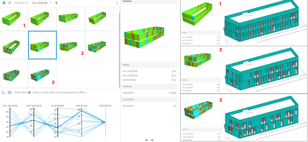

I've tried all the updates and still can't get the visualization. Dynamo is working and the create revit elements  function too, I just can't see the options thumbnails.

Solved, I was working with Dynamo for revit, and when I opened the script in the Dynamo sandbox I realized that there was a lot of packages missing. After loading packages some nodes was still working different than in Dynamo for revit, I did some adaptations to remove a custom node from lunchbox package and it started working in the gerenative design.
