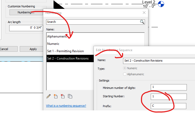

Hi
Is there a way to use multiple revision numbering system?  What I mean is for every stage of a project to have a diferent prefix on revision. Preliminary as P01, P02, P03 and so on, than for Tender: T01,T02,T03 and so on, and than for Construction: C01, C02, C03....I've tried to use numeric with prefix and alfanumeric as fixed figures but that work only with 2 systems and at first place alfanumeric have to be used othervise revision shedule is not in the right order.

Alfredo_Medina
@Anonymous  , @markcpduffy
Have you tried establishing a custom sequence with a custom prefix in this dialog box?

@YashshahEV wrote:
Can you please elaborate on the process used for getting this done. Also are we compromising on the clouds related to these revisions? Its require urgently, if you can help us, it will be really appreciated.
This is extremely easy in Revit 2022.  You can have as many Sets as you wish.

dtobitt
I've just upgraded our model to 2022 to try this, however, it did seem to go well with P1, P2 then T1, T2 but when I put C1, C2, it puts it at the bottom, i.e. in alphabetical order rather than date order, is there a way around this anyone know?  At the moment I've put xC1 to make it go to the top of the list
Sort the revision schedule by Sequence.
