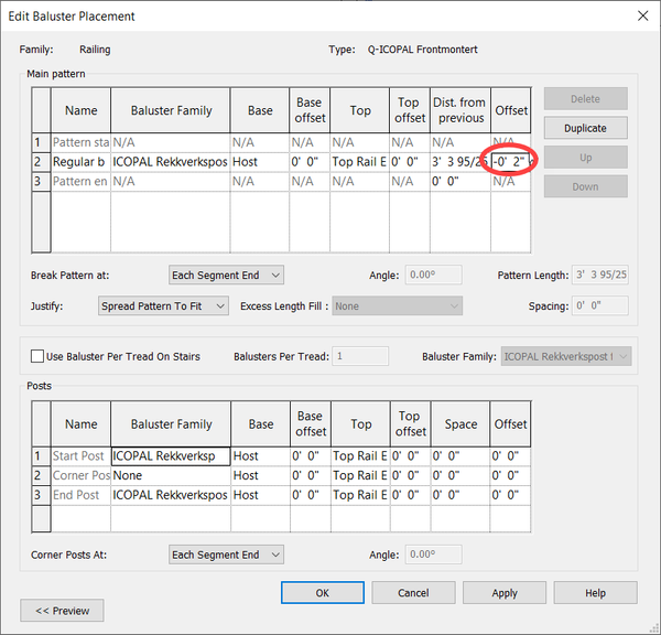

Hello Friends,
Can anybody let me know how to move these balusters 2" inward? I attached the files. Thanks

oops. I think you mean this:
Message 4 of 13
It didn't work. It doesn't move the first one.

What about changing the spacing of your start/end posts instead?
...I just opened your file. I don't see a way to do that as a contiguous rail using your rail type.

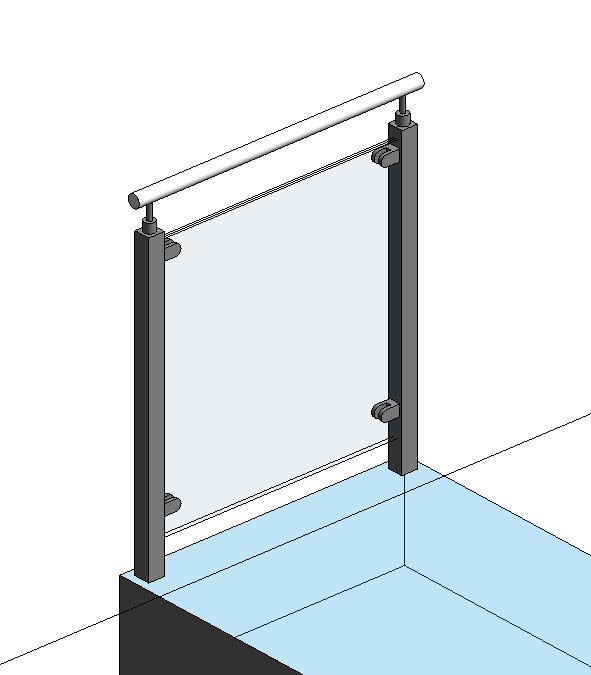

Yeah, I looked at it. I don't have an easy fix. I don't think there is one.  It's a challenge for sure.
...I would probably built it differently. I would not put the glass in as Railing, but instead as a Baluster Panel.

Toan, I don't want to manually edit the path all over the project. I believe you can find a way 😉

You know you can edit the Top Rail path independently and add 2" on either side. Just TAB-select it.  Wouldn't that accomplish the same thing as a 2" end post inset?

I fixed it as attached. Thanks for efforts
Now the problem is, how to shift glass 2"?
Message 13 of 13
I wouldn't inset the Post Balusters 2 inches.  I would TAB-select the Top Rail, press Edit Rail and then add a 2 inch sketch line at both ends.
You can't inset your Glass because it's defined as a continuous Rail.
