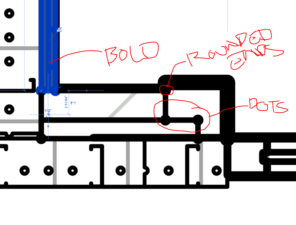

I'm trying to get my drawings to be much cleaner, and setup my templates better, but I keep having these problems that impede that ability.  The follow issues consistently elude me.
First, there is the issue of interior lineweights on walls or other multi-layerd components line ceilings.  There appears to be no rhyme or reason as to when it does apply a thinner lineweight to the interior components of a wall, or doesn't.  I'm just as likely that it makes the interior components thin, or bold.  and I don't know what category controls this.  I almost always end up having to use the manual lines overwrite to correct it, and while I suspect I'll always have to do a little clean up, I'd like to start getting my templates to do some more heavy lifting for me.
Second, is these random vertical elements that just generate random dots in my drawings.  I get this most commonly when I have sweeps in the section, but it seems determined to make these components and it drives me nuts.  Most of the time they aren't selectable and I can't get rid of them.  They look stupid and I think poorly made.
Last, is line type ends.  I almost always would prefer nice clean squared off ends to my linetypes, but the default appears to be rounded ends that more often than not poorly overlap other lines and make for sloopy drafting.  Any suggestions on how to modify these?
I've attached a picture that has all three of these conditions in it.  The one labeled Bold I've already manually updated, but it was the same lineweight as the perimeter lines, even though literally the brick wall right next to it had a much lighter lineweight between the brick veneer and interior air gap.

Are you cutting through some "very thick" model lines.  That could explain the dots.  Analytical Nodes might be another explanation.
lee.imbimbo86EM4
I tried just turning off the analytical nodes and got nothing.  What you're looking at there is a simple Wall Sweep for a Vertical Brick Pattern that wraps my openings.  But those dots appear more often than not.  but yes they do appear to be that for whatever reason Revit is over-emphasizing my vertical line elements in a Plan Projection, when it should basically ignore them.
The line weights for the wall layers, those lines defined by the walls structure, are controlled by the Override Cut Line Style and in the bottom right corner of the visibility graphics window. This is described in the About Overriding Host Layers help reference.
Your screen capture also shows what I assume to be a fill pattern to illustrate wall studs. Is it possible that the dots are an artifact from this fill pattern?
If it is a wall profile generating the dots, does the dot pattern disappear when you remove the wall profile? Hard to say with out posting the wall family in a test file.
That is unfortunately a built-in limitation of the software. But as any old-timer who used to draft with technical pens or mechanical pencils would point out, rounded corners were the default way to join two lines if you didn't cross your lines. Don't agree, then up-vote the Revit ideas post here: Line end style (2d)
There isn't anything you can do about the ends of lines. They are going to print rounded.
If this is a major issue for you that happens frequently as it sounds from our description, you will need to adjust your lineweights to minimize the difference. This is nothing new and should have been accounted for when the standards for the lineweights were set-up.
Rob
The dots are because you manually apply a thinner lineweight over thick
lines using linework tool.
lee.imbimbo86EM4
DOTS - Thank you ToanDN, CONCLUSION
Well, while not the solution I was hoping for, it definitely worked in terms of reversing my lineweight strategy.  Curious that it is more practical to assign the lighter lineweight as the default then bump it up as needed, rather than go in the reverse.
Not a perfect solution, but it definitely resolved my "DOT" problem.
LINE ENDS - CONCLUSION
In response to the line ends always being rounded, I knew that the older line ends were that way.  I guess I was hoping that by 2021's release they would've added functionality to control the line ends.  well maybe we'll get it before I retire, along with quality word document text editing.
