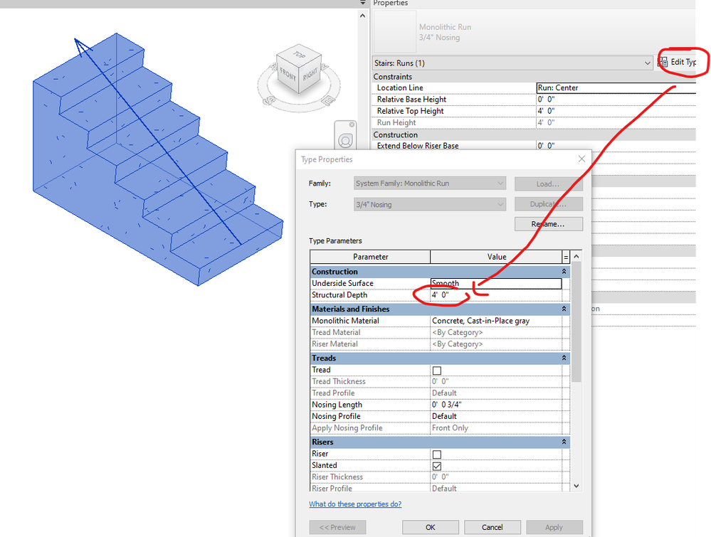

Why don't you create it as a monolithic stair? Set the monolithic depth the the same height as the landing then you will have a solid stair as you show.

I don't see "Structural Depth" can you make a tiny video and share it ...
Never mind I figure it out. Thank you so much 🙂
