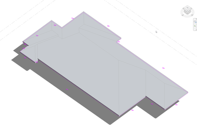

I've been trying to model an existing hip roof on Revit. But unforunately "Roof by Footprint" isn't generating the correct ridges from the data provided by the original drawings. The roof is at 22.50° Pitch with 450mm overhang which spans 3 metres.Front ElevationFront ElevationSide ElevationSide ElevationRoof Footprint (22.50° Pitch)Roof Footprint (22.50° Pitch)
I'm not sure what would be the best method to use in Revit 2021 to correct this issue.
Any help on this would be great.
Cheers.

Post the file. I'll beat it into submission.
...have you tried an "Offset from From Base" along with a "break" at the eaves along that jut out?
Message 3 of 20
Am I close? The whole Roof with one Roof Boundary Sketch.

Close but I modelled that front facade as a seperate roof because its slightly higher.
Message 6 of 20
The eave line is not aligned in the one I posted. Take a closer look.
the "jutted" roof is one foot lower.
...that's what I was elluding to when I asked you if you were using an "Offset From Roof Base".

I get you so instead of having two seperate roofs you can offset in the properties.
its about 100mm offset.
Message 9 of 20
its about 200mm offset.
Not a problem. 200mm is less than the 12 inches I'm showing. I think it's a pretty roof.  But if you want to do it as a separate roof tied into the other, then go for it.  Whatever works for you.

I just opened and looked at your file. Looks nice.  What wrong with it?
Message 11 of 20
See revised file.
Message 12 of 20
218563263
 How did you create the roof opening?
Message 13 of 20
Vertical Opening tool.

I'm confused. Perhaps someone can help me figure this out.
This is @218563263 Roof Plan:
This is the @218563263 original model; 2 roofs (over-built condition) unjoined:
After Joining to remove the visible edge between the 2 roofs:
This is @ToanDN's iteration of the Model; 2 roofs (over-built condition), but completely different "pop-out" roof and offset than OP's model and OP's Roof Plan (e.g. hip removed from one side of pop-out).
This is my iteration of the model; 1 roof - not 2 (e.g. no over-built) - and identical to the OP's model and Roof Plan.
So, what was the solution @218563263?  That's my confusion.

You helped to fix the roof and the result is exactly the same as what he has?
Message 16 of 20
That's what I'm asking you. I don't understand.  This is just plain goofy to me.
OP's Elevation taken from his first post:
Your Elevation:
My model, which is essentially the OP's model, but I eliminated the over-framed 2nd Roof by incorporating both into one single sketch/geometry:
Message 17 of 20
Message 18 of 20
Not to beat a dead horse here @218563263, but I think the "issue" you were seeing was extra linework.  Your original model was essentially fine.  That extra linework you were seeing could have been removed by simply joining your two Roof together using the Join Geometry Tool.
Unjoined condition:
Joined Condition:
Message 19 of 20
The red box indicates where the revit roof needs to be fixed to match the reference CAD elevations.
Message 20 of 20
Well, thanks for playing, @ToanDN
Yeah, I brought up that offset in Message 3 and 7.  Whatever; I'm not dissing your contribution. I like it.  I just thought the idea was to keep the hip roof (as per the title of the thread).
