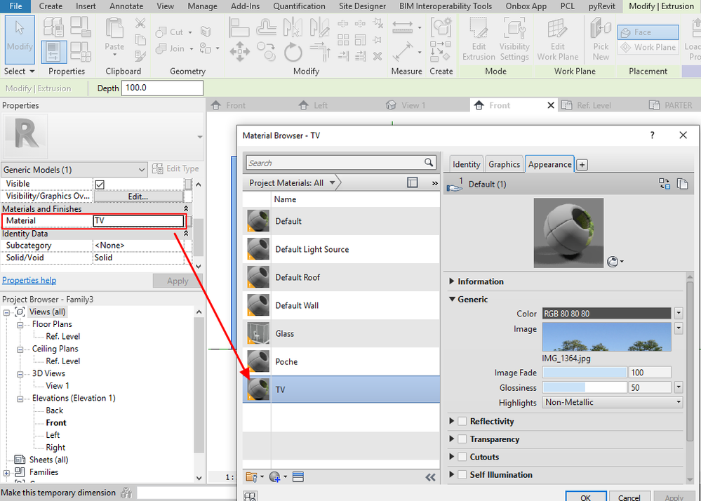

not a Decal , but you can use Material in Family:
  • in Family Editor create a new Material:
Edit the Material using Scale and Offset...uncheck Tile option (not Repeat):
the result in Family is something like this:
and, loaded in project is like this:

constantin.stroescu
yes , it can...
you can set the material in the Family , but you can also create a Material Parameter :
You can set only this Material Parameter and allocate the material  in the  Project but, in my opinion , is better to allocate the material in Family and the Material Parameter will be used only to change it , if desired into the Project...
now you have allocated a material but you have also a Material Parameter that appears as Parameter in Family Types:
Loaded into the Project , the Material Parameter appears in Type Properties , and it can be changed here,,,

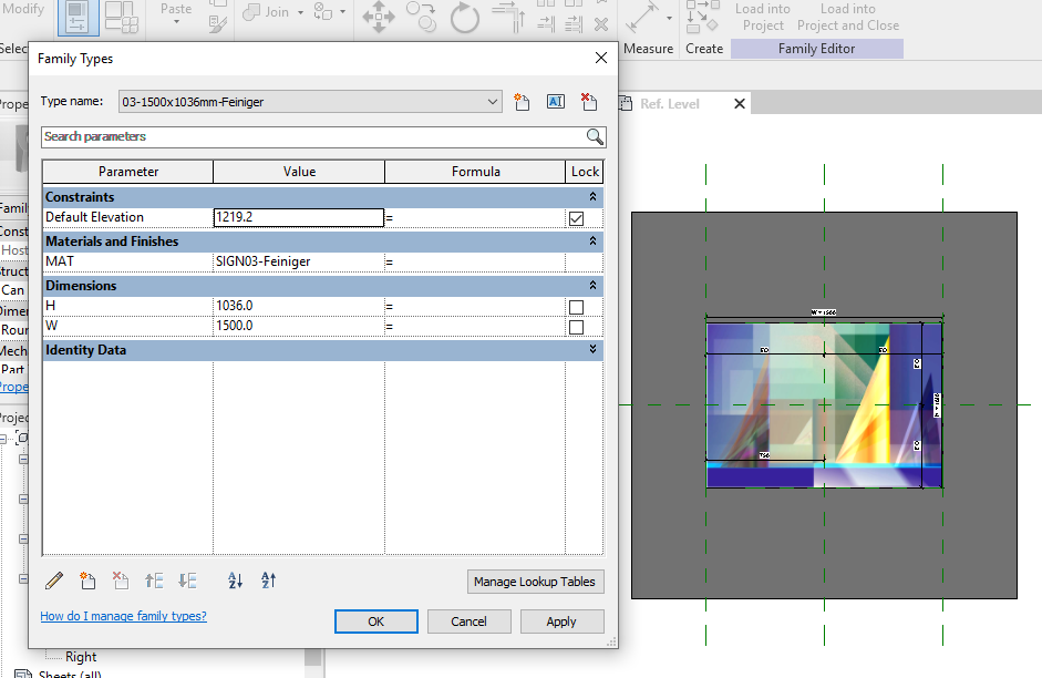

Message 19 of 25
danezeq
For now i did this:
Added a nested family inside the sign family, with no parametric size (because if the size will change, the jpg wont be placed correctly anymore) the nested family is just a plate with material defined as a parameter "Front JPG"
- I change the Front JPG parameter in the sign family, not in the nested plate family.
Now when i change type of sign, the front jpg changes well. But if i change to a sign which has another size, i should be able to hide the plate family which the irrelevant size. i'm still not sure whats the best way to do it.
i've attached the family file.
Message 20 of 25
constantin.stroescu
I made a test with a Face Based Family with three Types ( could be more) .
Each Family Type has different dimensions and different Material as parameters.
If there are many Family Types then they can be exported into a .txt file  : File>Export >Family Types. Then when you want to load only one or several Types you'll be able to choose from Family Table which Type(s)  you need in your Project.
Type 01 ... with its parameters:
 Type 02...with its parameters:
and Type 03...with its parameters (all Types of the same Family)
and here are the Material Browser settings for the Materials:
and a screencast that shows how it works:
https://knowledge.autodesk.com/community/screencast/cce64ad0-aa47-457a-8943-03fe7e2dfc85
Constantin Stroescu
