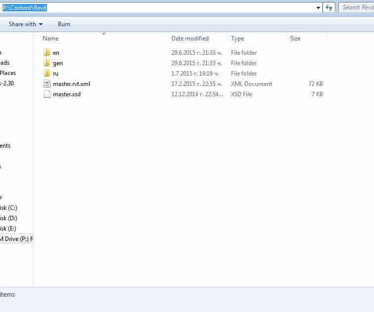

Dear Tony,
How to proceed if installation media is an .iso file of Revit 2016 ? In content\revit there is a master file as in the picture. I had issues with missing families and uninstalled Content Libraries. I need structural families.
Regards
