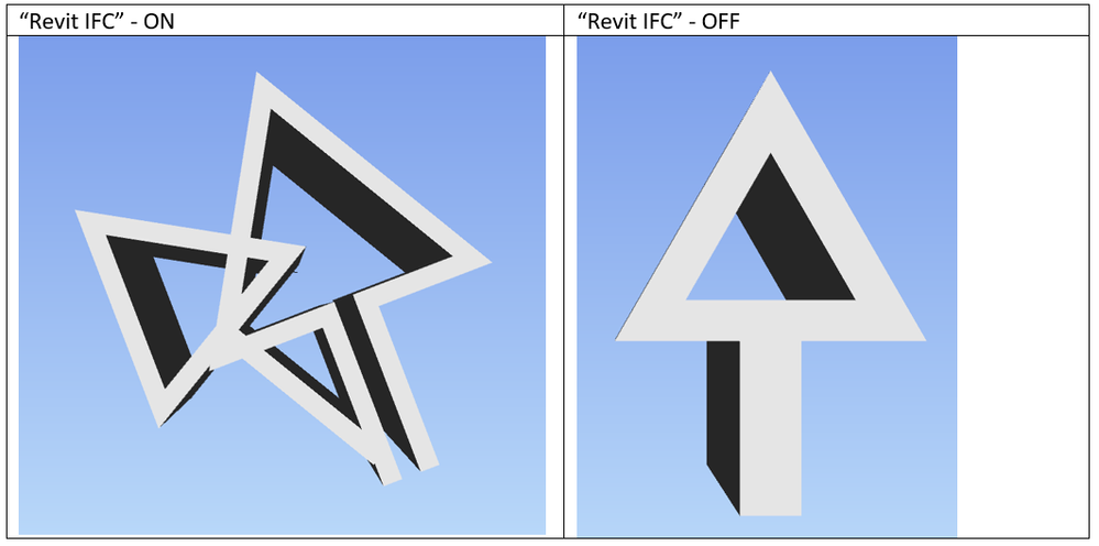

Dear Colleagues,
As i know - the problem is exists in all versions.
When Revit links IFC it make a wrong rotation of it (rotate according project north, not according true norht).
By my opinion it is application misstake.
This happens even with Revitexported  IFC.

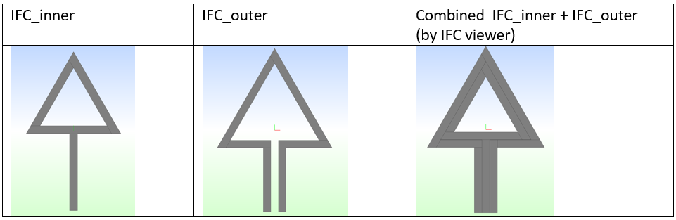

I created small test to illustrate it (files are attached):
2 Revit files with shared coordinates and different Angle to True North (wall arrow is orient to True North) and they linkin properly to each other:
 Also i exported them in to IFC (with Project Orign - Current shared coordinates):
Stranges begins when we linking IFC to Revit (blue - is IFC):
 I think this is very critical solution for coordination.
Also in NavisWorks this IFC are linking incorrect if IFC reading set to "Revit IFC".
 If this tik will be uncheck - all is correct.

This issue is still present with Revit/Navisworks 2022. In Navisworks the "Revit IFC" tickbox has been replaced by a "Conversion Method" dropdown though. Changing this value from "modern" to "legacy" is the same as unticking the former checkbox, and I can confirm that fixes the rotation in Navisworks.
