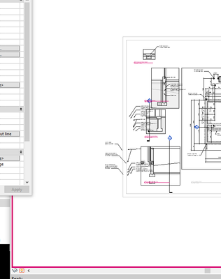

svalente9GJKH
Still can't get it...
Here is a screen shot, its all the detail views on the left:

Can you show a screenshot of this area?

svalen
Oh sorry, here it is:
Message 13 of 17
It looks good, thank.  Without the file to figure out the root cause, I would just go ahead and fix it by right clicking on each view under the sheet in the browser and remove it from sheet, then place them on sheet again.
