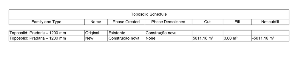

Can you tell me how much m³ of earth do i need to remove from original terrain in order to place the street?
I sent the test .rvt file below
Message 11 of 19
Looks like 5011.16 m3 - give or take. How are you going to mitigate those steep slopes? Retaining Walls?  If not, a heck of a lot more earth is going to need to be moved.

How did you reach 5011.16 m3?
Keep in mind that the only part that should count as cut is volume of the subdivision (if is located below the level of the existent earth), that represents the floor with its right tickness, in other hand the only part that should count as fill-in is the toposolid below the subdivision (if its located above the level of the existent earth).
I am doing some tests to put in prove if the count of earth movimentation of Revit really works in a real combat situation and not only on those beautiful scenarios that we see in youtube videos, and to be true so far it does not works. Because works only as long as i have a very simplified project with only 1 toposolid and without anyfloor, but as soon as i add floors Revit just does not have answer to deal with that.
Revit does not include in count of cut/ fill-in the subdision, which is good when i am calculating the fill-in, once the subdivision is the floor itself and not earth, we need fill-in with earth and not floor, its ok so far, but when we need calculate cut we need the volume of the floor, and we cant just count the whole volume of the floor because perhaps, depending the terrain relief not all floor will be placed in a place that is below the level of the original earth, maybe a part yes and a part not.
