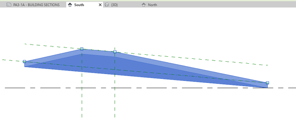

I am trying to model a roof like the attached picture.
I have tried creating a plain roof, and then modified sub element, but it could not guarantee planar faces.
I am also trying to make a mass first and then make roof by surface, but I could not make a proper mass form.
Anyone has an idea to do this? thank you!

Draw parallel ref planes on section so that you can modify subelements snapping to the planes to ensure planar surfaces.  4 lower points snapping to one ref plane and 4 higher points snapping to another ref plane.
Message 5 of 15
Simplify.  Create 4 roofs and shape edit each of them.

I only use modify sub-element command, and it looks much better.
Just like to know
1. Can the sub-element point snap to the other one? (now i just try to make them as closer as possible )
2. The wall can't attach the roof now ...

Modify sub-elements in a wireframed elevation or section view so that you see the ref planes to snap the points to.

The 4-roof method works and really helped me a lot!
