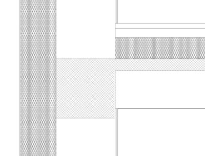

A clay block wall, through it goes reinforced concrete beam. Floor is a hollow block floor with 5cm thick layer of reinforced concrete poured over the blocks. That floor concrete slab and concrete beam next to it should be represented as a single "unit".
I can't figure out how to do this in Revit in sections.
This is how it should look:
And this is the best I could get it with Join tool, but it's still very weird looking because no one in my country draws it like that. Linework doesn't work.
Any way to improve this section?
Attached file with above example.

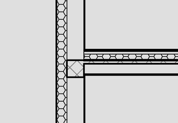

Notwithstanding of your Cut Line Weights, I think this is the correct Join Order. If you really want the Beam and the Structural Layer of the Floor to join seamlessly, like you are showing in your screenshot, then you need to also make their Materials the same (in addition to changing Layer Function/Priorities) .
I changed both of them to your "Concrete, Cast-in-Place - C25" Material for this screenshot:
You're right! Missed that my materials are not the same. Also, beam and wall should be those that join, not beam and floor, which is what I've been trying to do.
Any idea if line thickness can be automatically set properly? I tried V/G override, Override Graphics in view and Cut style override as other poster suggested, but nothing works because beam is now joined to the wall. I can get it with linework, but if manual clicks can be avoided that'd be great, at least for the beam.
Before linework:
After linework:

B.Fetzer
don't use "Beam", use "Floor Slap", (same material for both, slap and ceiling cover layer)
In the Properties of the floor change the function of both Layers to "Structur[1]",
Join Wall and Slap,
Change Object Style Floors -
--Common Edges Line Weight Cut to 4
--Slab Edges Line Weight Projection & Cut to 4Screen-Ceiling.PNGLineweight.PNG
This is a very elegant solution (Floor slab edge), but as far as I can tell there is no way to separate them in material takeoff, and in my country everything has to be separated in bill of quantities (1st floor: columns, walls, beams, lintels...; 2nd floor: columns, walls, beams, lintels...; 3rd floor: columns, walls, beams, lintels...).
Anyhow, I'm calling it solved with barthbradley solution. Thanks everyone!
