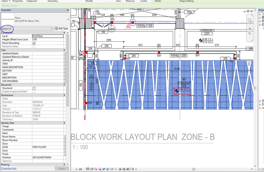

Dear Friends,
I have Differnt case to hide the Floor Boundary Line in Shop drawing,
In this case I am not able use Line Work (LW) Tool because i have to make lots of line to invisible mode,
If i hide the floor it self in Visibility Graphics Spot elevation for the related floor categity also hide,
So i need a another solution to hide the Floor boundary line,
If i use the white line for surface line, it make another problem. all the joining area (Floor to wall,) boundry line are not visible in print.
Please guys give me a solution i was struck this issue very long back
Floor BoundaryFloor BoundaryIf i use the white line for surface lineIf i use the white line for surface lineMy Out put is like this... in Lot os area..!My Out put is like this... in Lot os area..!

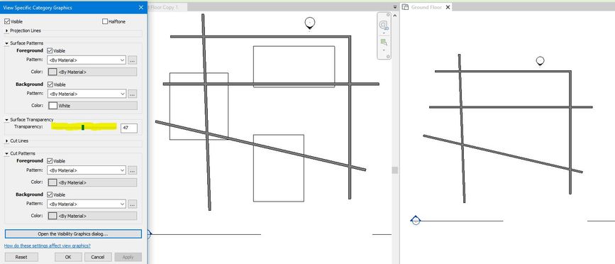

Try Transparency..
Transparency in Category..Transparency in Category..

Corsten.Au
Hello
To hide the elements below the floor, just fix the view range..
transparency + white boundaries should work..
If this doesn't help then I hope someone will come up with a solution.
best luck
Corsten

jlogesh1992
Deaar ToanDN,
Actually i was working the block work layout, here i want to show the Finished floor level and i don't want to show the floor boundaries, please read the full story.
And here some room two types flooring is coming for the architecture purpose, so that i have create the two different boundaries for two different floor,
and then flooring pattern no need show in block work layout drawing, so that i have hide the flooring surface, then floor boundaries are visible like a attached image-01
IMAGE - 01IMAGE - 01
SO THAT i WANT TO HIDE THE FLOOR BOUNDARIES HERE,
If i make the floor boundaries in white color, Floor to wall connection area lines are hide, so that i want to make the floor boundaries to be hide.
THANKS & REGARDS
LOGANATHAN J
