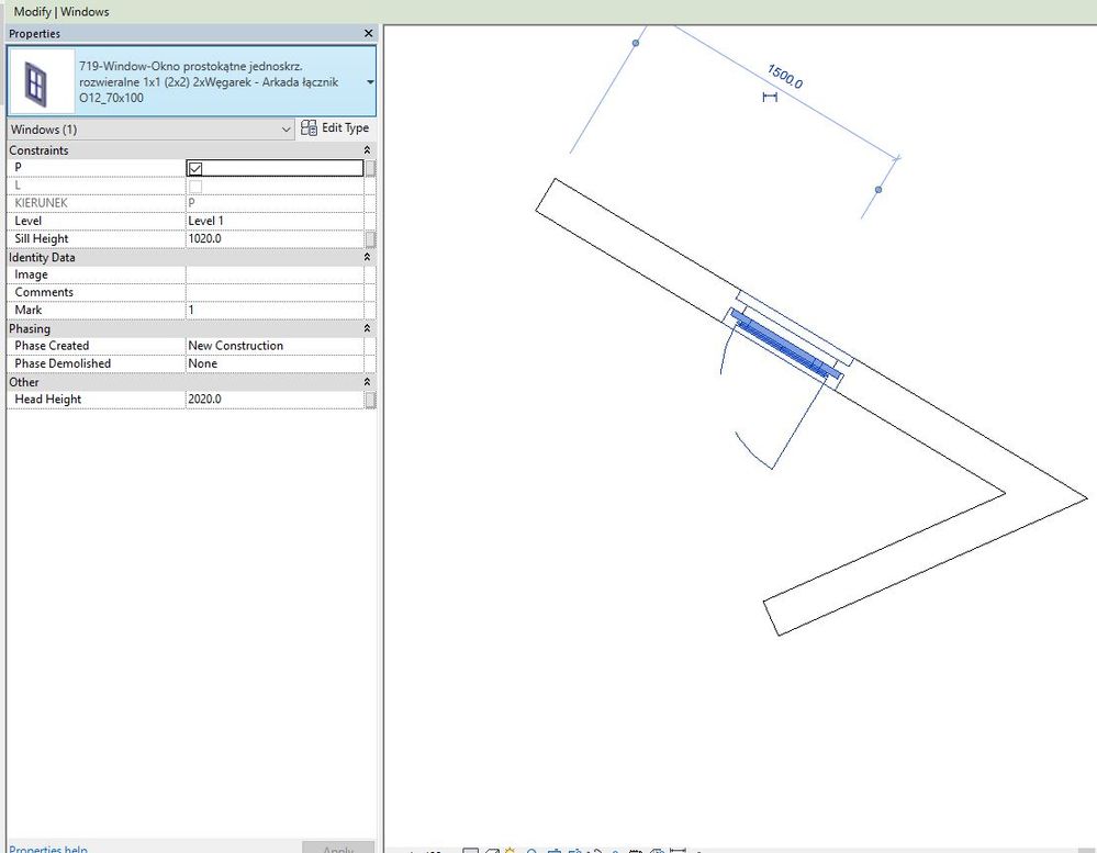

I need to clean up some shared parameters to my project - but cannot. Unwanted parameters are removed from Project Parameters and Shared Parameters, but they are still "binded" to family instances.
Is there a way to get rid of them?
Image after deleting parameter - it's greyed out and locked, but still appears to all Windows.
Anyhelp would be much appreciated.

Many Thanks for your reply Kuberan. Unfortunately, this parameter does not show up in the family editor.

That parameter does not show up in the Family Type editor.
It looks like its only in the Project where the family is loaded, as the parameter was added by Manage-> Project Parameters - added from Shared Parameters file.

The issue is: that deleted parameter still remains in the family instances, and is greyed out as on the attached image.
To more surprise, when I deleted more paramaters, only the last one remains - others are removed.
For example, when I delete parameter P1, P2, P3, then P1 and P2 are succesfully removed from the project, but P3 is still listed and greyed out.

@M_Perez@Sahay_RThe family itself, when loaded to another project, doesn't have this parameter associated - see images attached. Therefore I guess it's still the issue within the project file.
new project with the same family loadednew project with the same family loadedremaining parameter - while deleted it's greyed outremaining parameter - while deleted it's greyed out

@Sahay_RYes, that parameter is deleted from Project Parameters, and is not listed there.
@M_PerezThe parameter is in all Windows in the project which were placed before deletion of that parameter.
New instances of the same family do not have that paramater. Reloading family does not help, even with parameter override option.

As mentioned above, new instances of the same family do not have that old parameter. It looks as if it was stucked in the old instances.
"old' instance  of the family - deleted parameter still exists"old' instance of the family - deleted parameter still existsnew instance of the same family- deleted parameter succesfully removednew instance of the same family- deleted parameter succesfully removed
I guess the solution would be then to delete all windows and replace them.. But it's more than a thousand windows, so I would kindly say this method is not preferred.

Then you have your solution!
Replace your family with any other an then replace them again with the desired one.
