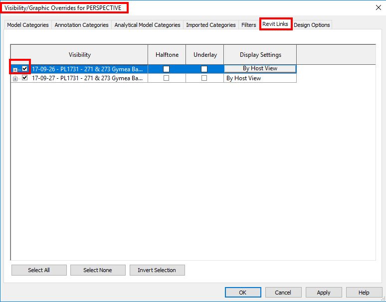

To "hide"/"show" elements that belong to a specific level, you should consider playing with the View Range. However, sometimes that is not enough because we don't want to unify the range of view. This is why we use Plan Region. Plan Region allows you to define multiple view ranges along one floor plan view... So, in theory, you could use all links in this project and just play with plan regions.
To hide/show a specific link using VG overrides, this is how you do it:
