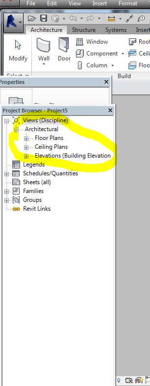

How to add Discipline
josemukalel
Howpb.JPG to add other Discipline Like structural or MEP

Keith_Wilkinson
Disciplines are hardlwired so you can't create new ones... You can create additional shared parameters to make filing easier within a discipline but you can't create a new parent discipline - would that help?

constantin.stroescu
It 's not very clear for me...Do you want to add other Disciplines from the list or you want to create new disciplines?
If you want simply to add from the list ,then make a duplicate of a view and change Discipline : Properties>Graphics >Disciplines> choose from the list ....then the category will appear automatically in Project Browser...

josemukalel
Thanks for screencast, Can i add Flooring (Finish) Plans as  Sub Discipline  under architectural Discipline .There is already Floor paln,Elevation,Ceiling Plan etc .I want to add Flooring Patten Plan

Keith_Wilkinson
I don't believe it's possible to add a new plan type.  You can add new elevation types and section types but not plan... although I'd love to be wrong about that...

Alan.johnson1970
You cannot create new disciplines yourself.
Normally you would start your project using a template file matching the discipline you require
e.g. use Structural template for a Structural project this will give you the correct 'Discipline' in Project browser.
For MEP, if you do not have a template file set up, you can browse for a template.
If you use Systems-DefaultGBRENU.rte this will give you Mechanical, Electrical and Plumbing folders in Project Browser
If you add Structural Floor Plans to a project created with a different template  (View Tab> Plan Views> Structural Plan) then a folder will be created called Structural Plans

ChrisNeedhamNZ
Yes, you can add as many Floor Plan types as you like.
With a plan view open, in the properties palette clieck "Edit type," then "Duplicate," then name you new Floor Plan type whatever you like.
You can then set a view template to be automatically applied to any new views created with that Floor Plan type.
