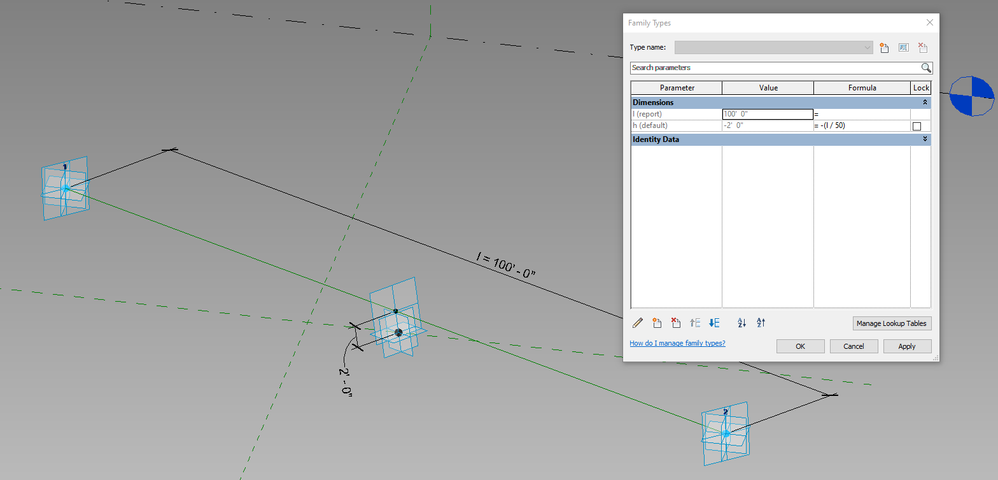

You don't drop the midpoint, but host another point on that midpoint and offset from host a distance equal 2% of the chord length.
heichan88
Hello ToanDN
now I :
setp (1) make a point B offset L/2 to start point adaptive A
step (2) make a point C offset L*0.05 to B
step (3) add adapitvc end point D with a reporting parameter L to A,
seems work --- is that correct? any other way?
Please advice thanks
Try this family.  It was done exactly how I described earlier. I repeat the steps here:
- place 2 points, make then adaptive
- create a ref line thru the 2 points above
- place a dim between 2 points, associate the dim with a reporting instance parameter [L]

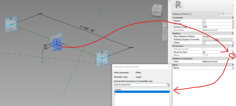

- place a ref point in the middle of the ref line, no need to add dimension or constrain, it stays in the middle of the ref line automatically (beauty of adaptive family)
- place another ref point using the midpoint as host, select the new point and change Offset from host to a arbitrary value from properties
- associate Offset from host with another instance parameter [h], enter = -(L/50) in the formula box of [h]
