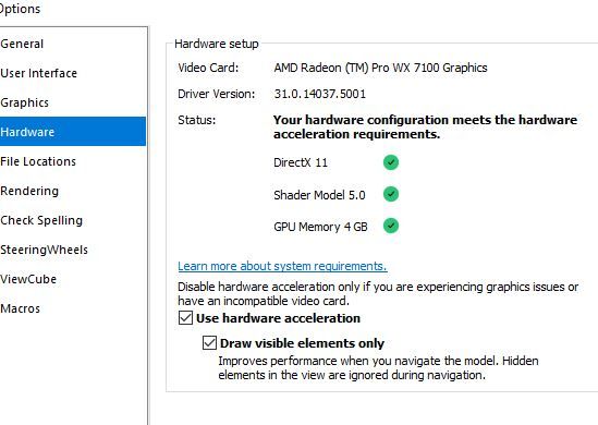

I recorded a 30 second clip of the issue , link above. Also I attached a before and after picture of the action.
Basically it is only Revit 2023 misbehaving, even after multiple uninstalls and install to see if it would make it go away.
It occurs even with a blank template.
Symptoms, during window select to the left (all) or to the right (per element) and drag on screen it distorts the graphics of any visible line or model, making lines disappear, get thicker, or overlaying of same image but bigger size, once you done doing the window select and stop the dragging it goes away.
Simultaneously 1 to 4 green squares the size of a pen tip appears on the top left corner of active window, they populate during the window selection and drag process.

What does Revit report in Options regarding the video card/driver? Is the mouse unique, have multiple buttons or options that could be interfering? Screen resolution and scaling greater than 100%?

What does the Hardware tab report regarding the graphics card?

Here is the hardware tab pic

Okay, Revit isn't flagging an issue with the graphics hardware, that's good. In my case it wasn't Revit or Autodesk Software "failing" it was a service pack update for Windows that would not install. The lack of that patch seemed to cause issues with Revit 2023 starting...or Autodesk 2023 etc. It appears that something in the installation of 2023 required something that the failing update provided and I was missing. Once I got that update applied the software worked again.

JoshuamRivera
Just sharing more in case others run into the same case.
I just downloaded latest drivers for AMD Radeon Pro WX 7100 drivers.
And tested Revit 2023, it made the green squares go away.
It made the the other issues go away.
The only two that persist is during window select process it makes the graphics distorted, some lines would disappear, some lines become broken, but once you done with the command it goes back to normal.
During mouse wheel click and drag, makes everything look like it has grains running through it, once you done with the command it goes back to normal.

Found the fix
Case Symptom
-Revit 2023 update from September , installed first time last month created graphic issues
Solution
-Restoring graphics card settings back to default + Download latest drivers
