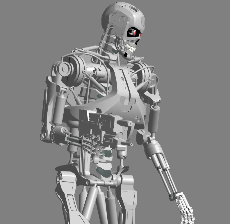

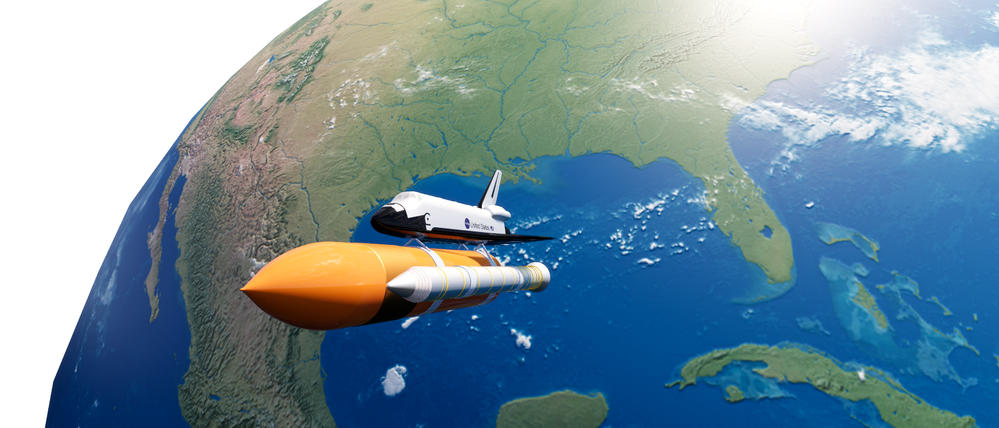

syman2000
Just want to showcase what you can built with Revit using only point and spline through point(s). These are few example the stuff you can built inside Revit without needing any special software or dynamo.
Goku Transform.pngGoku Complete.pngstormtrooper 3.pngstormtrooper 2.pngstormtrooper 1.pngT-800 finish 2.pngT-800 finish.pnghomer3d revit.pngSPACE SHUTTLE REVIT EARTH.pngmario revit finish.png
