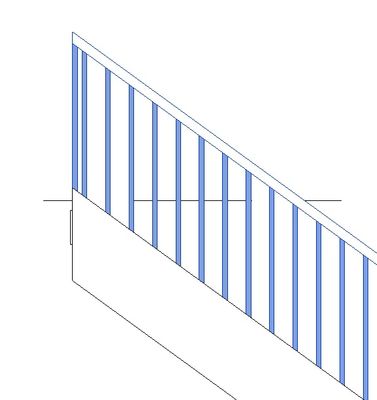

HI,
The top rail is flat @ top of stair case (for top step), I would like the rail continue straight up not flatten out.
When I create a new stair case the problem persists. Please see attached.
But when I open a new project the rail is parallel to the stair case which is what I want.
Flat top rail @ top step
HI,

Adding an extension doesn't change the flat section(at top) within the staircase.
The problem is the flat portion within the staircase instead of it continuing up parallel with bottom of staircase

this is when I create a stair case in another project. it works

Tick End with Riser for your Run.
When you place the railing, choose On Stringer instead of On Treads.

@info
One click you select the Stair
You need to  TAB and select the RUN then check End with riser
@info

Thanks that worked.
