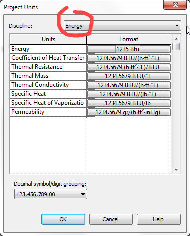

thats great ive got it working i think. just wondering does revit let you use (MJ of energy). instead of converting it to joules manually. just run these screenshots by you. i used the ICE database for values for now.

yes but (MJ of energy) isnt there just joules.
