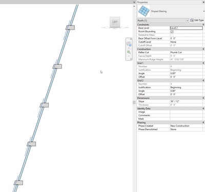

Can't you use a Sloped Curtain Wall System Family for this instead?
Message 5 of 14
No the four sides of the mullion profile would follow the slope of the mass. As described in my post, I want three sides to be parallel with the floor slab and one to follow the mass face. Per the image.

I tried this to see if this could work and my mullions still follow the surface, any advice?
Message 10 of 14

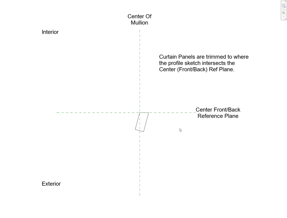

The mullion profile itself need to be draw at an angle that matches the angle of the sloped glazing. Sorry, I'd send you one I did, but I didn't save it. But I believe it looked something like this Profile.  It took a couple or three passes to get it right.
Message 11 of 14
Ah okay, I misunderstood. Yes this would require a different profile for every time the surface changes and for each associated system. There are about 7 and changes every week so this would be extremely time consuming.
