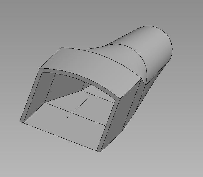

I've created :
- a generic model (the profile named P)
- nested in an adaptive component family (1 adaptive point orienting my profile Global (Z) then host (XY) named O)
- nested in an adaptive component family (named S)
In S I drew a spline driven by 3 points. I put various profiles along the spline. I want them to be always vertical and perpendicular to the spline in XY. When the 3 points are on the same plane, everything is fine. But when I move one adaptive point so that my curve is non planar, the profiles are not perpendicular to the spline any more.

FAIR59
I think the placement of the profile-family in the family O is the cause of the problem.
You probably have used the default placement, ie placement on the Ref Level. In an adaptive family the Ref-Level behaves quite quirky, I can't make heads or tails of it.
Open the profile-family, in Family Category and Parameters check Work Plane-Based, and uncheck Always vertical.
Reload into family O.
Replace the profile, using the Place on Workplane option and select the appropriate  reference plane of the adaptive point.
Reload into family S.

Message 14 of 19
FAIR59
As you have discovered, using only 1 family you can have either a vertical profile or a profile perpendicular to the spline.
To find a horizontal line, perpendicular to the spline:
  • Make a 1 point adeptive family containing a circle on the horizontal plane of the adeptive point, placement point orients to Host (xyz).
  • Make a 1 point adeptive family containing a circle on the horizontal plane of the adeptive point (same radius), placement point orients to Instance (xyz), family property Always vertical checked.
  • Place the 2 families on the same point on the spline, the circle of the first family will be perpendicular to spline, the second will be horizontal.
  • Place a reference point on the horizontal circle, click the [ Host Point by Intersection ] button on the option bar,  select the perpendicular circle. The point has now moved to the intersection of both circles, a line between the placement point of the families, and this last point is horizontal and perpendicular to the spline.tripod1.PNGtripod2.PNGtripod3.PNG

onurcan_mizrakQXTQS
Hi, I have tried the 2 main methods that you mentioned and there is a regeneration error everytime I try to move the adaptive points on the z axis, Solid is very different from just making profiles, can someone please help me on creating that, here is the error and the intended behavior an the other is without the error and correct profile orientation. The profile is a family with one adaptive point with Intance xyz orientation option.
Thank you!
Message 19 of 19
onurcan_mizrakQXTQS
Hi, finally figured it out, just needed to redraw the profile in the profile family from the front view and put it on the last point which is the intersection point.
