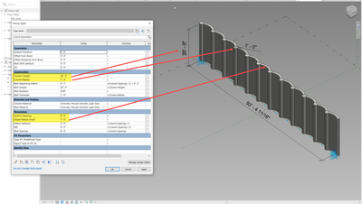

Hi and happy new year,
I am trying to create a dissolved bored pile wall family.
I have already created a bored pile wall-Family which is being placed along a line using the General Line-Family Template, the Array-Tool and some functions in the parameters.
What I am trying to do now is to place a small wall in between two bored piles.
However, there are two significant problems_
  1. I cannot load a wall or wall family into another family template (at least it did not work for me)
  2. When using an extrusion for drawing the wall the length and curvature are not variable and cannot be adressed via the parameters
The attached pictures might help to understand my problem.
I am using German Families (if this is necassery in any way)
Thank you very much!

@Ilias_Mitrakos7GPRF wrote:
Since this is company data I am not sure if I am allowed to post the family
Huh?  Am I understanding you correctly?  You're not sure if you are allowed to post a Revit family that you cannot build and therefore can't use because it's deemed "company data"?
All that craziness aside, is this what you are trying to do?
If this is what you're after, the family in those screenshots was built with Adaptive Families and Repeaters. That's the nuts and bolts of it. I'll check with my higher ups to see if I can divulge more information.  Maybe they'll even let me share a "redacted" version of the family with you.  In the meantime, Google "Adaptive Families" and "Repeaters".

Ilias_Mitrakos7GPRF
Thank you very much
That should solve all of my issues
