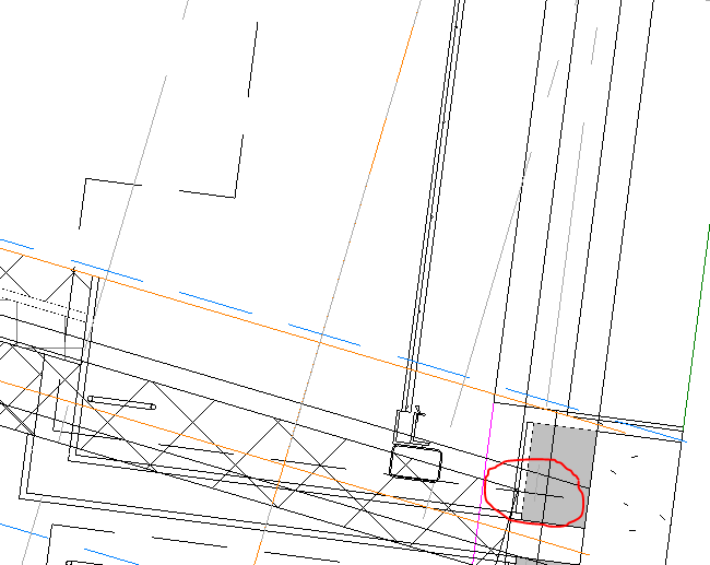

just to hijack this thread a bit with a different question--@barthbradley, I had included symbolic lines previously to show the box above, but I keep having the issues of the lines overrunning where I want them to stop. I have the door set back a locked distance from the face of the wall, but the symbolic lines always add back this offset, even if I connect them to another symbolic line spanning the opening and lock this line to the face of wall reference plane. Is there a way to lock the end of a symbolic line to a reference plane? Screenshots attached.

If you TAB-Select on the end of a line, you can cycle to the end point which will be represented by a tiny blue dot.  Is that what you are asking about?
...align and lock that end point to a Ref. Plane.
Nachricht 9 von 9
als Antwort auf: Anonymous
whoops that's so simple, don't know why I didn't try? Thanks @barthbradley!
