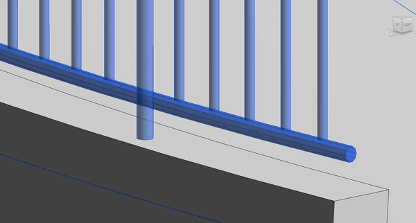

Hello everyone,
i want to connect railing to spiral staircase but can't..
Can anyone help me?
I cannot attach files. pls see the link below.
Thank you so much.

magicdl96
als Antwort auf: RDAOU
Sorry for my english not good and thanks for your answer.
I want my railing to be on top of concrete ledge. I choose ramps as host  but how much I offset, some places will hit the concrete ledge and some places will be open.

magicdl96
Yes, I know the problem has to do with concrete ledges but we don't do them. We only draw railing. So that's the problem.
Is there no other way to link correctly?

lucdoucet_msdl
als Antwort auf: magicdl96
@magicdl96
From your model, here are the "Spiral ramp" components:
Actually, the two guard rails are hosted to the light grey Revit ramp family "Ramp A" and not hosted on the "Ramp ledges" which are part of the InPlace generic model family.
I presume you modelled an additional dark grey Revit ramp family which I labelled "Ramp B" and tried to host the guard rail to it, which will fail because the guard rail path does not overlay the ramp area.
This said, to height of the guard rail posts and assigned with a vertical offset of 135mm from the host while the top and bottom rails are at 260 and 1310mm from the host.
As the guard rail is ignoring the "Ramp ledges", if you want to adjust the height parameters of the guardrail, you must do so relative to the host height (which is the top surface of the Revit ramp family) in the Revit guard rail type parameters.
This said, I am not sure which problem you are trying to solve. Maybe sketch the desired result on top of a screen capture?
