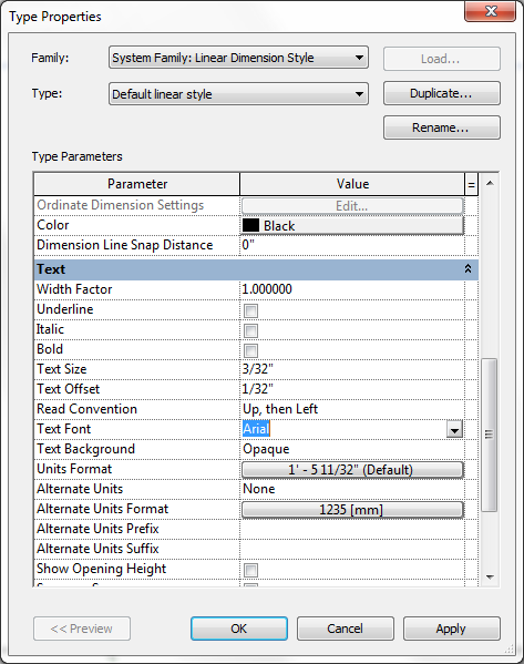

...have you tried changing the Dimension Style Font?
