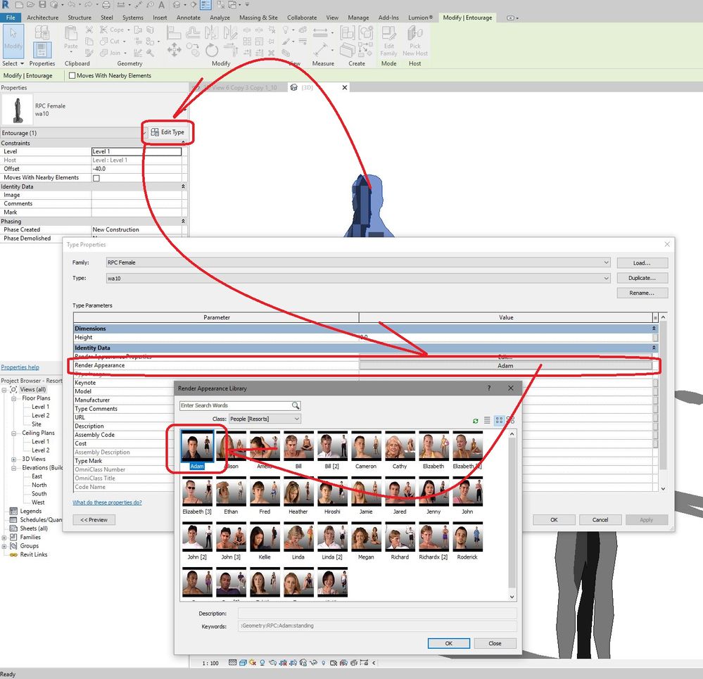

…. There are two ways to fix this
… 1 – try this:
…. Click on a box – turn that blue
…. Click edit type
…. In render properties – click it
…. Choose an RPC
… and click ok to everything

I have tried this method to find files in render appearance but nothing comes up in the box.
I have reinstalled Revit and all default files. The families load correctly on their own but just in project.
Any help would be greatly appreciated

mjh52V7QV2
I am using Revit2025 and the base RPC trees that come with it.  I try to do what you said, but the menu that opens up is completely empty.
