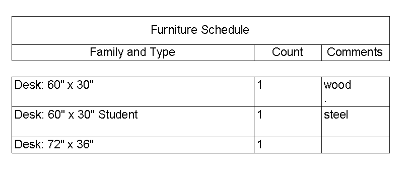

Shift+enter and type in a period or paste in an Unicode character if you want no dots.

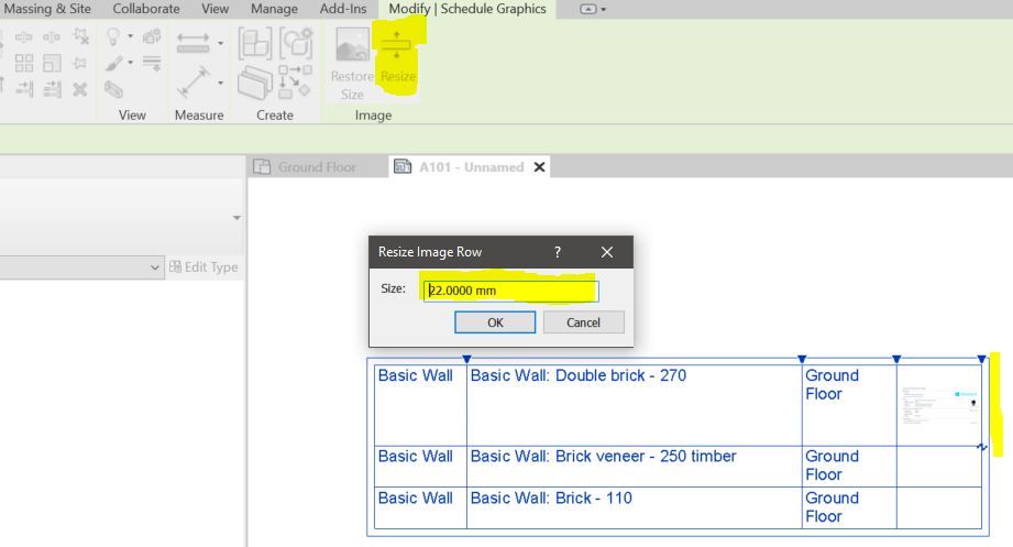

Horizontal resize is available any time...but verticle one gets activated if you have an image parameter in the schedule..
check this out .
Resize ColumnResize ColumnResize RowResize Row
