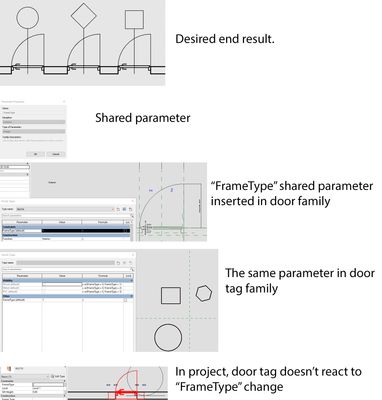

What I need: our door tags have different symbols on them, depending on door material. One symbol if the door is made of wood, another for metal, third for plastic.
I want to create a single tag family that will "read" what material the door is made of, and change accordingly.
I started by creating a shared parameter (integer) which I inserted in door family. 1 would be wood, 2 metal, 3 for plastic.
Then I inserted the same parameter in tag family and set up formulas which drive symbols visibility. This work fine in tag family.
But when inserted in a project, tag doesn't read what is set for the door. I thought maybe tag parameter will automatically see the value of the door parameter, the same way labels do, but clearly they are not connected in any way.
Is there a way for doors to report a value to the tag family, and have the tag change automatically?
- Why don't you just create different tag types?
- Because our tags have to respect door directionality, and Revit doesn't recognise doors directionality. To clarify, looking at a plan view, if doors open up - tag must be placed up, if doors open down - tag must be down, if left, left... This way i'd have to have 4 families each with 3 types, basically 12 different tags in total which I'd have to manually set for each door! Keeping track of that when something changes in project would be difficult and, more importantly, very error prone.
Thanks in advance!

Parameters in host family can only control LABELS in tag families.  Therefore, you can utilize formula in a calculated value Label to change the Label value.  The value can consist of a string of text, a blank space, special characters for custom shapes.

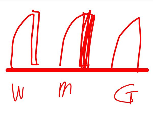

You must have worked for a nut firm. I never heard of such directional door tag, in any books/manuals. Besides the point here, perhaps you can suggest changing the door graphic instead, as shown.
So theoretically, if I could create a custom font with only those three symbols, I could create such "door material dependent" tag? Although I don't know if creating font with such thin lines is even possible...
Nope, this is standard in my country. This is how it's done. This is how everybody is doing it. So suggesting some radically different way of tagging doors / windows wouldn't go over well. If there is no way of automating it I will have to create different families/types and do it manually, AutoCAD style.

Could you please point me in the right direction how to do this. Almost every tutorial I found deals with calculating actual values (areas, occupancy). If they do deal with text then the formula for the calculated value is IF(then, else) which allows only two values to be determined, and I need three.

if ( condition is met, "text string 1", "text string 2")

I think you want a nested IF statement.
IF (<condition>, <result-if-true>, IF (<condition>, <result-if-true>, <result-if-false>))

It works! I didn't know you can nest them, but you can even have multiple levels of nesting. This way I got four symbols, forth one being nothing i.e. an empty space, which is what we use for openings. Now to create custom font, I'll report back how well it worked out. Thank you!

Works! Even better than expected because "lower/right" and "upper/left" can share a type, so I just need two, not four. Now to figure out if making everything movable and stretchable is at all possible, but that's another topic for another thread.
Thank everyone for helping!
