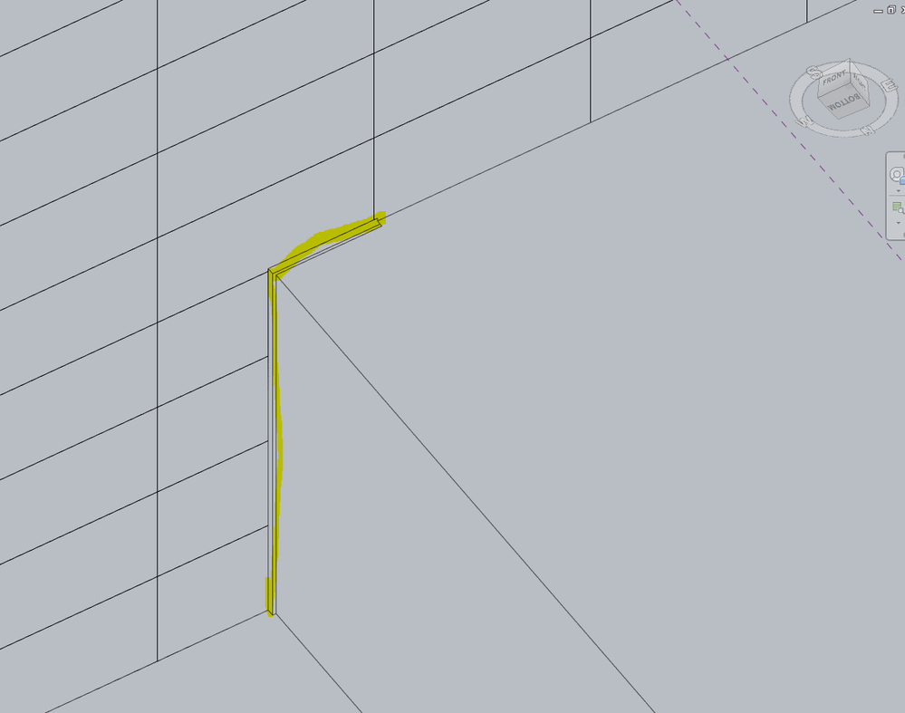

I have a very simple case:
a surface (not rectangular  is divided into a grid pattern.  I have an adaptive curtain panel assigned to fill this pattern.
why is there a 2" overhang of my curtain panel when my Border Tile setting is set to partial?  It trims perfectly on some but not on others. (See attached pic)

From the screenshot I can’t tell how the surface is shaped. A curved surface could cause lines from different parts of the 3d geometry to be displayed (instead of overlapping).

parleyburnett
Yes, I have attached an example family.  I have observed that for some reason any 'angled' side of a surface that is not 90 deg will trim the panels 2" outside of the actual surface.  Why won't it trim perfectly to the surface boundary?  Why is it always 2"?

I see what you are describing, and this doesn’t look like the behavior I would expect (based on the help description of this option).
I’ve logged this behavior with our developers (so that they can investigate the issue further) and written the following article to track the issue:
Revit: Partial Border Tile option 2” past border
We will keep the article updated with the findings from the investigation, as they become available.

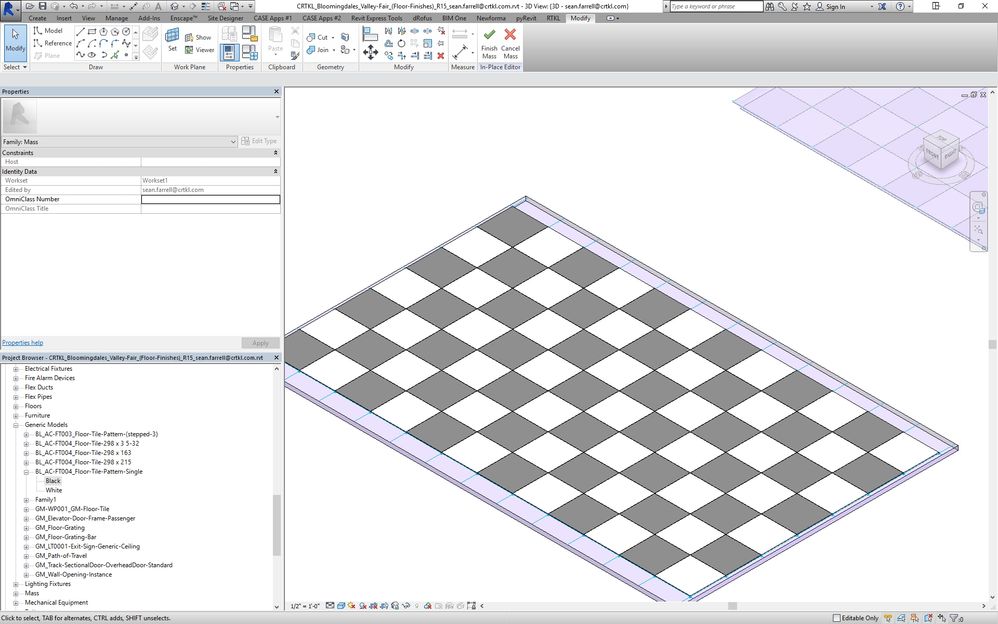

They have not fixed this issue yet, and i doubt they actually will. However, here is something that may help you. Being adaptive component, divided surface, etc., there are mannnnnnny different ways to tackle this problem. The best luck i have had in resolving this issue is to do the following.
Step 1: If you have a simple rectangular based pattern, develop a separate Pattern based family, as a simple extrusion (example attached).
Step 2: Load this family in to your project
Step 3: Create a divided surface from a mass.
Place Pattern Based Family HerePlace Pattern Based Family Here
Step 4: Enable nodes on your patterned surface. (do NOT use the pattern based surface option, and select your family, this will result in the error with overhangs, this is where this whole logic breaks down).
Step 5: Place your pattern based family on the node points,
Select Repeater
Step 6: Repeat step 5 until you get the pattern you want.
Step 7: select the repeater command based on the module repetition of your choice.
Finished Surface. Edges can be created with new  repeater. completing the surface with no edges
This isnt a perfect fix, but it can at least eliminate the overhang issue, and it will actually schedule the family! whereas loading it as a pattern, if you have multiple types of panels/surfaces, you wont be able to schedule them, or their properties.
We implemented this following example for a patterned floor with checkerboard tile, to include varying tile sizes, as well as doing quantity take offs of each tile.
